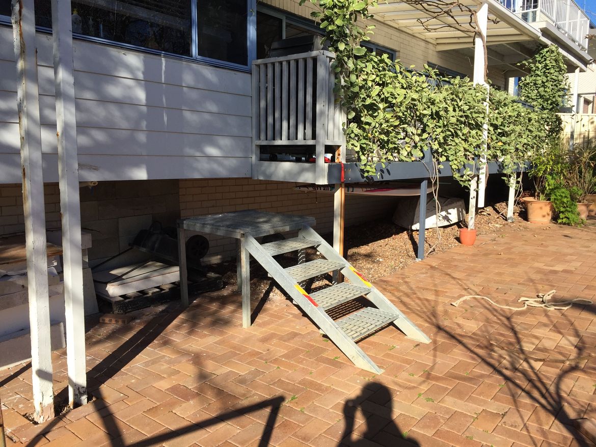

I need to replace 4 supporting posts under 2 verandahs. The old posts are steel and have corroded as we are in a high salt environment. I have purchased four 4X4 Merbau posts for the job and am going to raise the foundations for the posts slightly to keep the posts out of the ground. I am going to use bricks or concrete blocks as foundations for the posts (or should I pour concrete). The foundations vary from just w few cm to as much as 30cm high. My idea is to support the posts on steel styrups which I will fix into the bricks ( or with bolt heads set into the concrete onto which I will put a nut and washer to hold the posts down). This method, I am hoping, will make the replacement of the styrups in the future a simpler swap and the posts should not be degraded by the environment.
1. Do you agree with my methodology? Please make any suggestions.
2. Also, should I coat the posts (and with what) or should I leave them uncoated?
3. If i am to use a concrete pad, should I set up the posts in situ first and then pour the concrete into a "box"?
