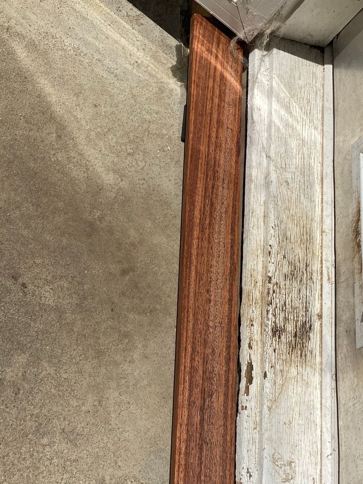

Hello Mitchell ,
I have begin measuring for the deck and discovered that the exterior from my laundry door on the porch is not square just wondering if there is a way around this as haven’t dealt with the issue before?4A4F09DE-9765-4E72-B7FA-EA5C685A4424.jpeg

Hello @rick6947
It all comes down to how you want your decking panels laid out. If you are putting it down with no picture frame and you are starting your layout from the outside going in then the last panel will have to be cut down to fit. Generally, the decking frame is adjusted in the planning stage to take this into account. This means that should the last panel need to be cut down, only a small portion of it will need to be cut.
Would it be possible for you to post a sketch of your decking plan and how you plan on laying down the decking panels? This will give our members a chance to assess the layout. We can then make recommendations on how to proceed.
