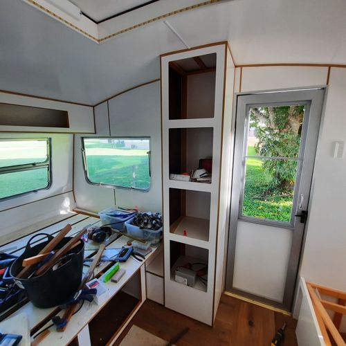

I have just finished relining my little 10ft Franklin using white leather caravan ply from ForestOne (a Bunnings supplier) because it's only 3mm thick so very lightweight. Regency panels are 9mm thick and made from MDF so quite heavy by comparison. To get the tongue and groove look, I have seen 6mm marine ply used and shallow lines routered into it to great effect, this keeps the weight down and gets the look you want.
Hope this helps

Hi Jude
