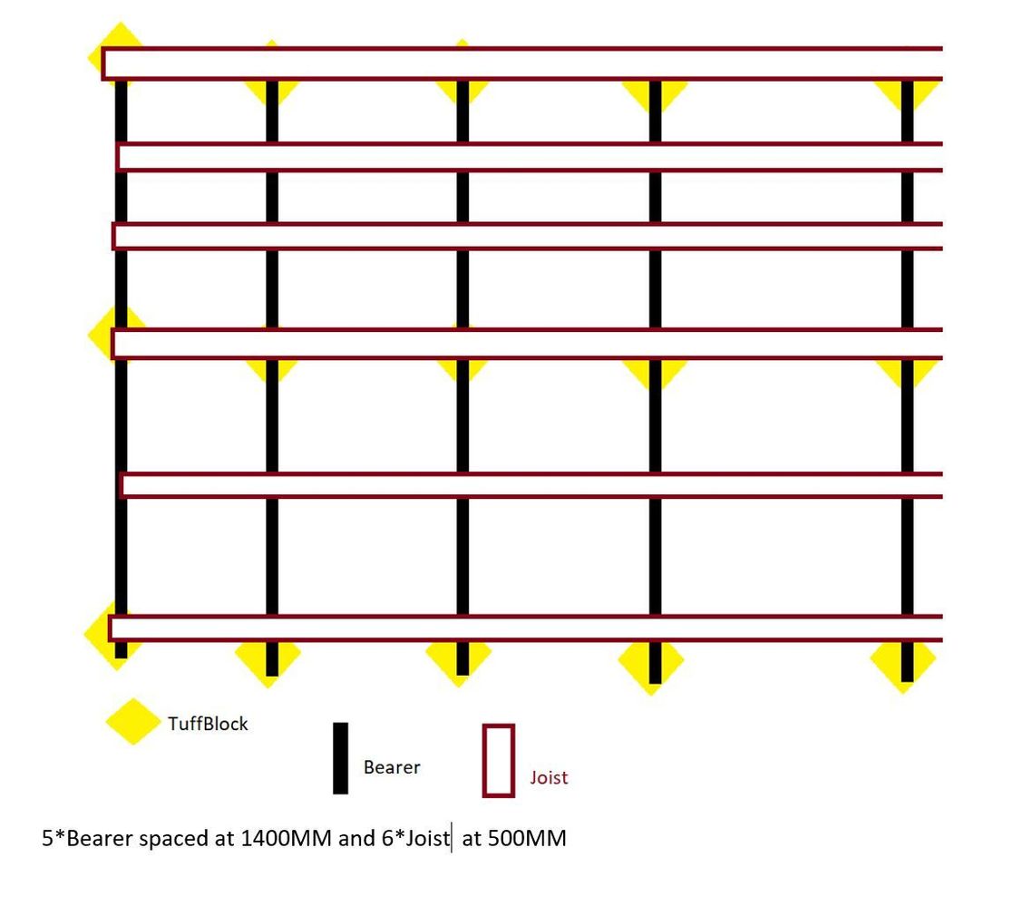

I think 6 bearers at 1400MM(approx) distance sitting on 3 Tuffblocks each and 6 Joist on top at 500MM(approx). All using Treated Pine Outdoor Timber Framing 90 x 45mm.

Hi Pan (@rpankaj39),
I'm not quite following how six bearers spaced 1400mm apart would be used on your 2.8 x 6m deck. If you could draw a quick sketch illustrating your proposed layout, it would be helpful. Joists spaced 500mm apart sound correct.
Hi Mitchell @MitchellMc
Sorry, I think it would be 5 Bearer +6 joist. Please refer to the below diagram and Ignore the spacing in the diagram. It is a dirty drawing :).
Having the 90 x 45mm timber span 1400mm between the bearers is starting to be a bit of a stretch and almost at its allowable span distance. I'd be more comfortable if you re-assessed and had the bearers spaced at 1200mm. This would be the same for the bearer, and it would be better to have four supports instead of three.
The issue with pushing limitations is that, at the least, you'll end up with a spongey deck that will flex underfoot as you walk on it, and at worst, a deck that could potentially collapse.
