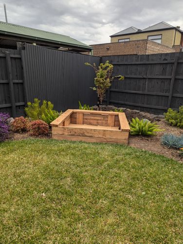

This is the sandpit I've assembled. Most of the cuts have another sleeper already on the end of it so aren't too exposed. How do you treat these ends?
Are there any non toxic and clear sealing solutions? I'm just a little worried of it leaching into the sandpit and garden as the ingredients of the ones you suggested look pretty toxic.

I suggest looking at linseed oil, tung oil and danish oil. These options are safe for use around plants, animals, and children since they don't contain harsh chemicals. Please remember to follow application instructions and that the oil must be fully dry before using the sand pit. Please keep in mind that some danish oils have additives so make sure your getting danish oil that is safe.
