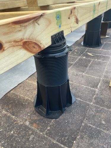

Quick update on this—thanks for your suggestion, @EricL I agree that your solution is the way forward. However, as a first-time DIYer, cutting 45 posts to varying heights felt like too much effort.
I looked into Nurajack but initially couldn’t find much information. After some research, I discovered that Bunnings NZ sells them. I had a conversation with Lewis from the Nurajack NZ team and felt confident enough to proceed with their product.
I ended up ordering the Nurajack PRO3 with Joist Head (155–420mm)—it’s priced similarly to Tuffblocks and also requires 90x90 posts.
I’ve attached a picture of the Nurajack PRO3 I used. It feels solid compared to another product I initially purchased but couldn’t use due to the required adjustable height.
