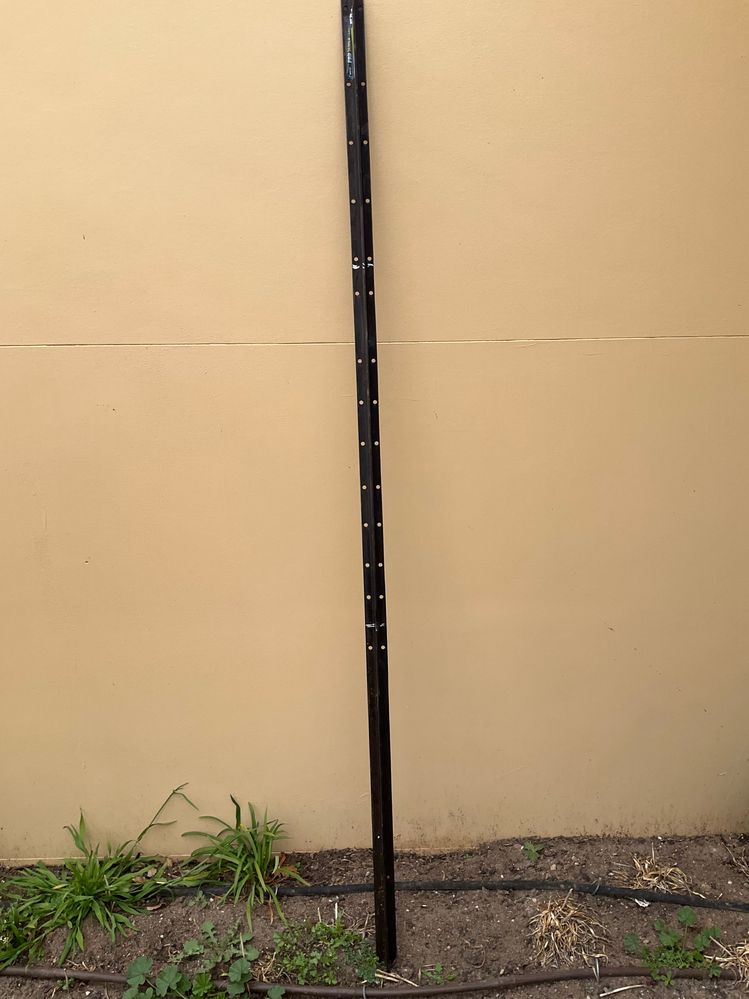

I need to cut steel fence posts (pictured). Whar reciprocating saw blade would be best to use with the Ryobi tool ?
Cheers Celt

Hello @celt
I suggest using the Diablo 9" Steel Demon Reciprocating Saw Blade For Thick Metal. It is designed to cut thick heavy steel like the fence post and is compatible with the Ryobi reciprocating saw.

Re: what reciprocating saw blade?
Hi Eric.
Thanks for the suggestion .Worked perfectly
Cheers  Celt
