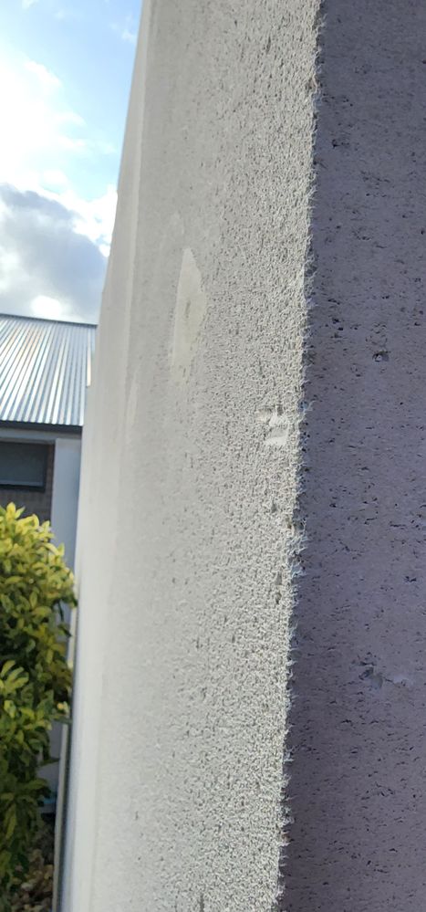

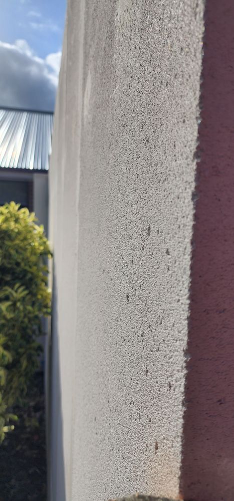

Recently I have renovated with Hebel panels, and I want to know which of the above is suitable for outside of the panels. And also, please recommend a product that can be use.

In order for us to make sure we are referring to the same product, would it be possible for you to post a picture of your wall? This will allow us to positively identify your product. We can then make recommendations on what paint product to use on its surface.

Hi Jason, Its Power panel XL. on the boundary.
