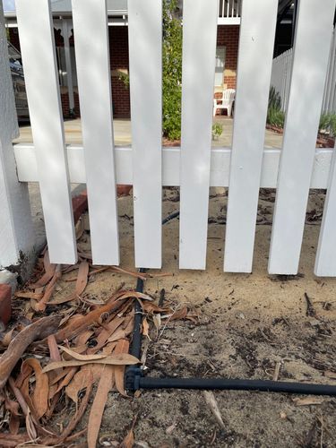

My picket fence is too long at the bottom. I would like the cut the panels shorter so that they don’t touch the soil before I start planting.
What’s the best tool to cut them shorter?
Thank you!!
Hi @ee,
Thank you for your question about cutting the palings on your fence.
I would start by getting a chalk line and pinging a line where you want to cut. This will give you a good straight line to follow while cutting.
A circular saw would be the best tool for this situation provided you take care to ensure the irrigation and mains water meter are not damaged. However, due to the in-situ nature, this is not a "beginner-friendly" cut and I would not suggest this if you've had no prior experience with a circular saw.
If you are not experienced with a circular saw, I'd recommend sticking with a hand saw or enlisting the services of a professional to assist.
Once cut, ensure to add 2 coats of paint to the bottom of the palings to prevent water getting in and rotting them out.
Let me know if you have further questions.
