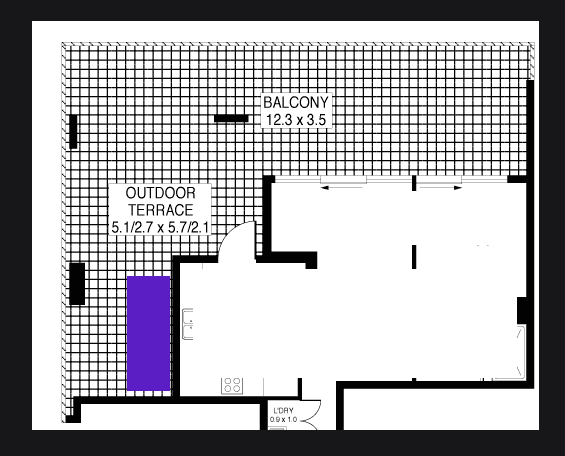

Yeah I can understand the reticence I've been umming and ahhing for a long while about it.
The balcony is massive, it's more of a terrace really. But it's also largely wasted space, and I've been putting things in this area in storage boxes for the last year but I want a place to store bikes, larger tools like a table saw, and a workbench.
I've added the shed in blue, it's pretty close to scale. With it being undercover and in the corner, the wind load should be reduced. The height of the balcony is 3m, and there are solid glass balustrades of 1.1m along the edge.
The door and roof should be rated to these levels, I'm in the Illawarra which does get some strong winds, and we've had some grim storms, but it's still only in wind region A - I know that is made different by the altitude, but we definitely don't get cyclonic winds here. The shed is rated for Region A, Region B & Region C
