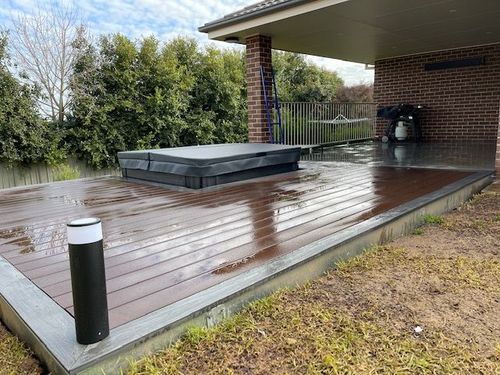

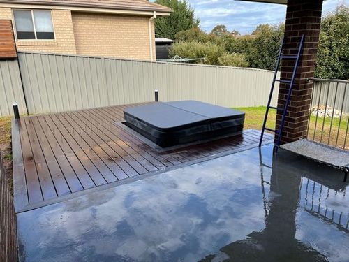

I have recently completed an outdoor raised deck using Steel Deck and Eko Deck boards.  Stage 2 is to add a deck over the existing patio and flush with bifold doors - raising the deck about 90mm.
Plan is simply to run joists every 450mm with an edge beam attached to the house and attach these using dynabolts and brackets as the patio isnt completely level.
Question.  What dimension steel should I use for the joists ?  The distance/width of the deck is 4200mm and I was going to cut short steel blocks to go under the joists to level them.
Appreciate your help and apologies if this has already been asked.image004.jpg

Thank you for posting a picture of your decking project. Are you using Ekodeck for your follow-up decking project? If you are, you can deduct the thickness of the panel from your available space. For example, if your available space is 90mm, less 23mm which is the thickness of the decking panel. That leaves you with 67mm usable space. If you allocate 10mm for adjustment for height, that will then leave you with 57mm.
