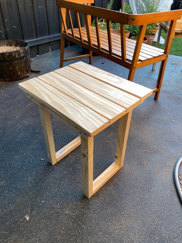

Hi all, I’m a total newbie at this sort of stuff. Today I made a side table for outdoors. I want to stain it next but I’m unsure of my next steps or product to use as a google search just confused me. So I’ve  just used dressed pine  I haven’t attached the top 4 pieces yet as I figured I should stain it before attaching. So any help with staining is greatly appreciated.

Your next step would be to sand the rough edges or splinters so the table is ready for coating. I would suggest using Flexovit 115mm x 1m 240 Grit Painted Surface Sandpaper Roll
Once you are happy with the result I would suggest using Cabot's exterior stain and varnish. This includes the colourant and a protective varnish coating. You can apply this product with a brush or a small nap roller for a smoother coat.
Let me mention some of our keen woodworkers @Poppop, @r23on, @woodenwookie to get their opinions on the best stain and/or coating for your project.
Please let me know if you need further information or had questions.

Nice job on the table @cristina . As usual @MitchellMc  has all the bases and good ideas covered. Only suggestion I can add if you're  a newbie is if you have to sand anything follow the directions of the wood grain and when you stain it closely follow the directions on the can.

@MitchellMc Another two question in regards to this... if I wanted to use a clear varnish what could I use? Again looking through everything I’m a bit confused as to what I should use.
And also if I wanted a stain but soemthing super light in regards to colour what would be the best option?
thanks once again!
Re: what stain?
@cristina,
We have a range of Cabot's Clear Exterior Timber Finish which would be suitable. The varnish coating alone will give a super light colour change to the timber, the colour of the timber will appear more prominent and cast honey-coloured hues.
If you were going to apply a stain and then a clear over the top you would generally just use a 2 in 1 stain and varnish such as the Cabot's exterior stain and varnish. There are many colours available to select from.
If you have an offcut of the timber and take it into a helpful paint expert in-store, I trust they will be able to show you some colour options and/or try some on the timber for you.
