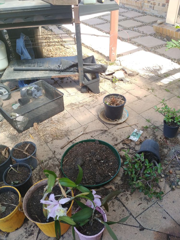

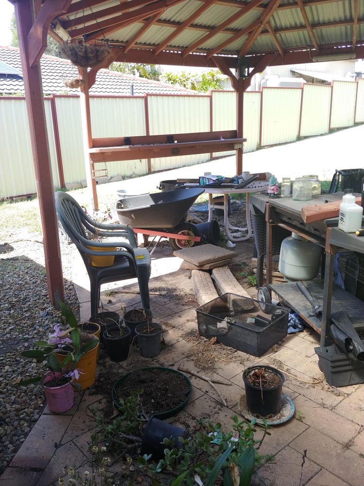

My house has a pergola that was already here when I bought the house. the floor of the pergola is really badly done pavers. I plan to build a deck over the pavers. There appears to be a bewildering number of choices of wood for decking and joists. Can anyone suggest types and sizes ? I don't want to spend a fortune, as long as it doesn't start to rot in a few years. I'm open to modular panelling if that is an economical choice. I'm planning on using the 50 mm adjustable support footings from Bunnings. My only woodworking experience is shelves, coffee tables and a desk. It will be about 40m2. It's a bit messy in the photos because of other work I've been doing. The original pavers have been laid directly onto the ground.

In the meantime, would you be able to provide photos of your pergola and the pavers so our members have a better idea of your project and can suggest some timber options that are more suitable for your requirements and space?

Thanks for your reply. I've added some photos.

Hey @pepsp Thanks for that advice. The pergola is hexagon shaped but I'm going to make the deck rectangular to reduce the complexity and to cover the gravelled area (or weed farm as I call it). I was planning to use the Deko 250x150x150 concrete foundation blocks for the sections on the soil/grass. It will be at floor level but not actually connected to the house which means council approval not needed here. I'm thinking at this stage I'll probably go with pine because of the size and prices have gone up since 2020, but I'll do more research yet.
