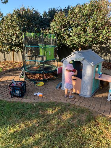

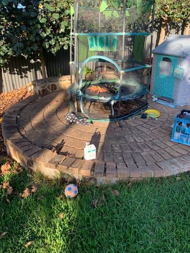

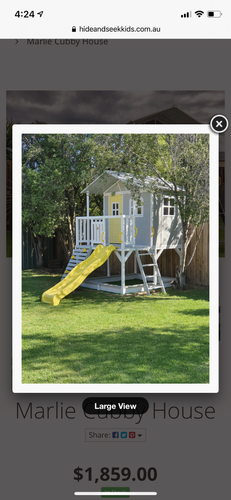

Hi, I’m in need of some advice on what surface to place our cubby house on.
We have ordered the Marlie cubby house from hide & seek (pictures) and the location it’s going currently has old uneven pavers with a big hole in the middle where a tree was (pictured).  We’re planning on pulling up the pavers but are unsure what to put down in it’s place.
Some options we have brainstormed are new pavers, grass, fake grass, mulch or rubber pour playground surface which might be out of our budget or a mix of material.
what has others put under and around their cubby houses?
thanks for your help 😀

Re: cubby house base surface
Hi @katew1,
The bricked area appears to have been built on a slope, so if it is removed, you'll either need to lower the entire area or level it to the current height.
Would the cubby fit on top of the existing bricks? They appear in reasonable condition, and if you were to clean them up with a high-pressure sprayer, they would look quite nice. The bricks that have sunken around the circle's perimeter could be lifted, filled underneath with sand and then relayed. That would allow you to spend the funds that were to be used on new grass, pavers or mulch on rubber pavers. I'd encourage you to place them around the climbing wall, slide and ladder.
All the ideas you have mentioned will work, and it might come down to personal preference on what you choose to use. However, some consideration needs to be made on how you'll contain the mulch, and some garden edging could be used.
I'm about to put some synthetic grass down around my daughter's playhouse, as it is extremely hard-wearing and looks quite nice. It's on a concrete slab, but as the cubby is not elevated, there is no risk of falls.
I look forward to hearing about your decision and seeing the completed project. Please let me know if you have any questions.

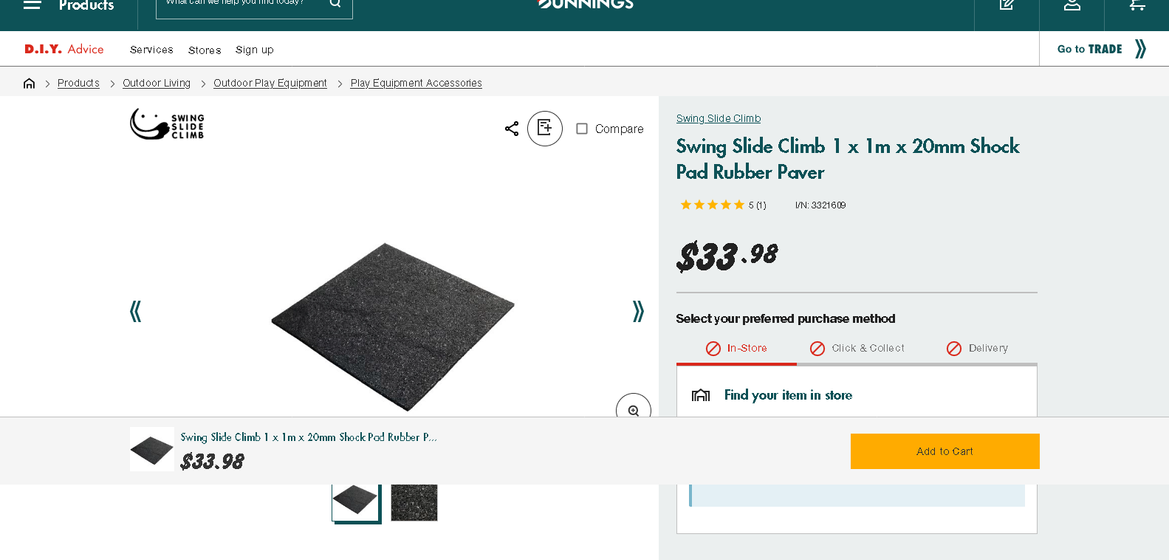

Hello @katew1
My suggestion is to use Swing Slide Climb 1 x 1m x 20mm Shock Pad Rubber Paver. It can be glued on to your existing pavers to prevent movement. It is rated for playground safety. Once laid down you can cut it to the shape of the existing paved area, that should save you a fair bit of work. It is weather proof and should provide years of service.
Cheers,
Red
