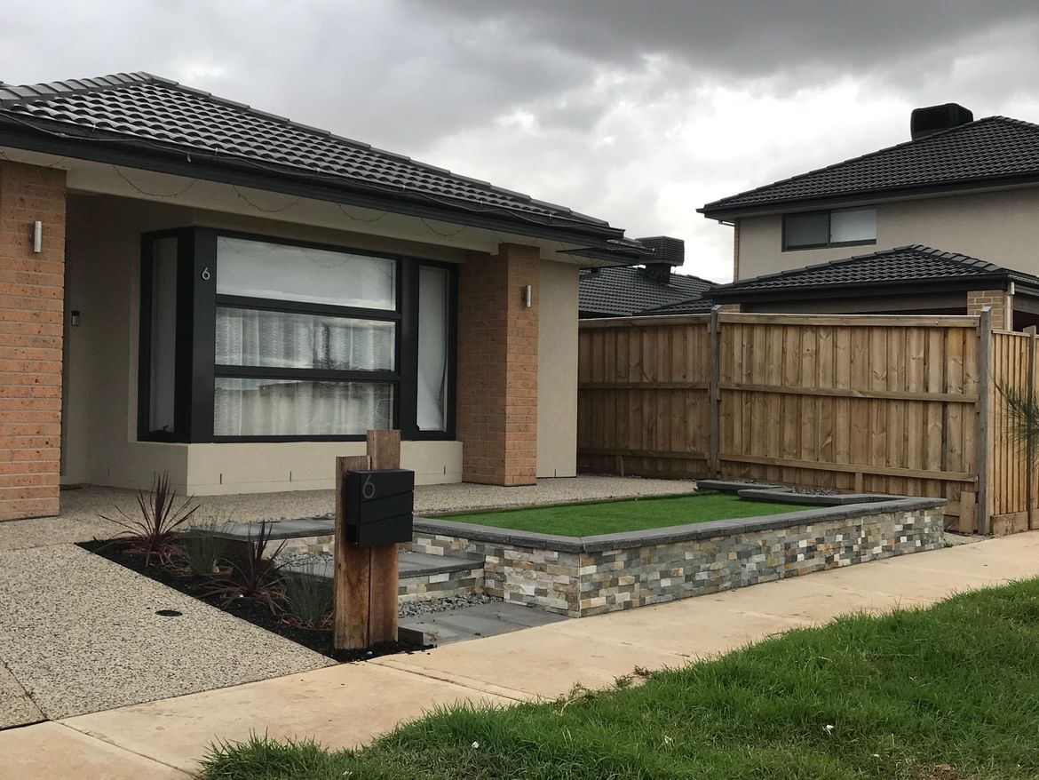

Re: What to use to stick vertical pavers to besser blocks?
That looks fantastic, @ravstk! How long did it take, and is there anything you would have done differently?
Many thanks for sharing your finished result. I trust it will inspire many of our members to attempt something similar.
Well done.
ravstk
Budding Contributor
Thanks, Mitchell :). I took my own sweet time on this one,  but I worked on and off on it. I'll say around 4-5 months in total. It was a process, where I got stuck few times but learned few things along the way. I mainly got stuck on the construction of the steps, as I was a bit unsure what products to use. Ended up with concrete pavers,  which in hindsight,  I think was a good choice, as they are heavy and sturdy. I probably could have planned better I think,  and should have spent more time leveling the base.
