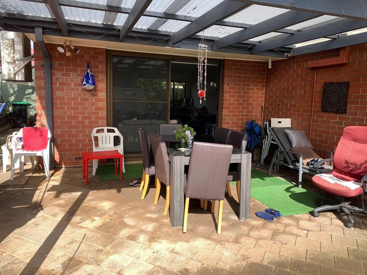

I want to build a deck in my backyard. I have a pergola there. I have existing pavers there and thinking of building the Deck on top of the pavers.

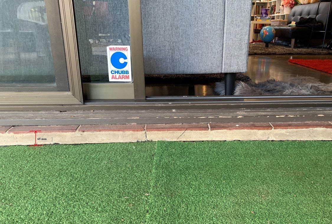

The problem is the height. To match with the house, the deck must have a height of 65mm.

With the height of the base (18mm) and that of the Deck (19mm - SpecRite 90 x 19mm Pre-Oiled Select Grade Merbau Decking), I need a bearer with a maximum height of 28mm.

- if this very low height would create any problem for the deck (the pergola has a roof)
