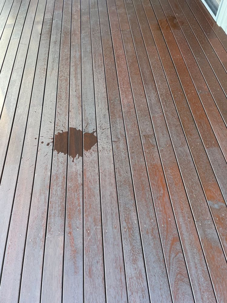

Thank you so much for this info. This is my first time maintaining a deck and I don't think I did a very good job of re-oiling - I maybe used too much oil or after reading your message maybe it is fading really quickly.
I've attached some pics of the exposed half.
The pic shows the  half of the deck that gets all the sun.  Top right is the corner that only gets the  last few rays of the day. Water is still beading well. The majority of the rest of the deck  gets the brunt of the day's afternoon sun. No longer beading and it is faded.
Thank you again. I will be oiling it very soon!
Cheers,
Re: When to re-oil a deck
Hi @cassy1,
Yeah, there is definitely some fading going on. I'd give it a good clean with some Cabot's Deck Clean and an Oates Compact Deck Scrub Brush, allow it to dry, then apply a thin coat of your decking oil to the faded area.
The cleaning step is essential as it will remove any surface contaminants that can affect the absorption of the oil.
You also want to go thinner rather than thicker on your application because you want the oil to soak in, not form a film on the surface. When starting out, two thin coats are better than one thick one, and for reoiling purposes, one thin coat should be enough.
