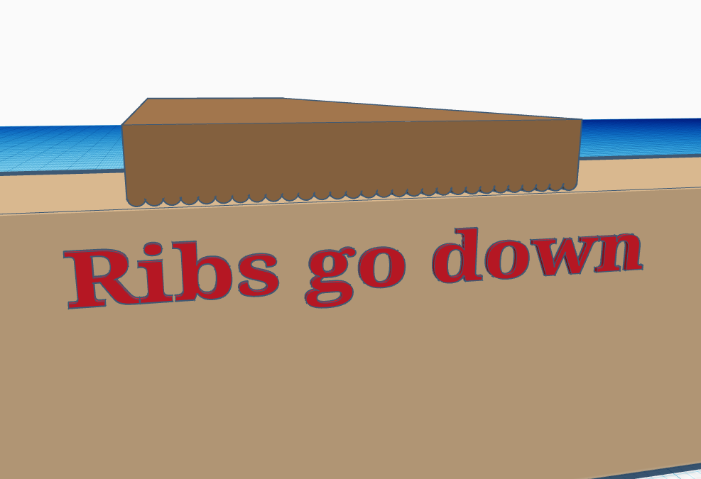

The things I want to know here is : when lay the Merbau Deck Board which side is face up and which side is on bottom .
Because I look at the Board two side are the same .
Any one can help or give the idea , how to look at that case .
Thanks
Welcome to the Bunnings Workshop community @Aisbett1_11. It's wonderful to have you join us, and many thanks for your question about laying decking boards.
If your Merbau boards don't have ribs on one side and both sides are smooth, either can be placed downwards. The only time there is a top and bottom of the board is when ribs are on one side. These ribs always go downwards. I've included a rendering to illustrate.
