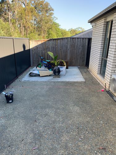

Hi there, I am building a low level deck and would like to know what stirrups you would recommend for the subframe supports.
As pictured, the deck will be placed over an existing concrete slab and compacted crusher dust.
The deck details are:
Overall size is 3.4m x 3.7m.
Joists at 450mm running along the 3.7m.
Will be using an aluminium 75x50mm sub frame for the bearers and joists with stirrups at 1550mm along each joist and bearer.
Aiming for an overall height of 150mm - 200mm.
