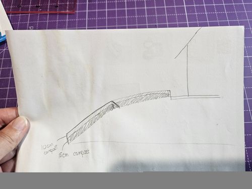

Photo will give you a better idea of what I mean. So I basically sheet mulched the slope already; the top edge of the mulched area is there the yard starts to slope. So adding some addition dirt on top really didn't change anything.
What I'm talking about now is the area between the mulched strip and the house. It's essentially flat (very slight slope) and pretty much level with the house so I'm worried if I add another 30cm of material that water could pool next to the foundation.  I can't plant in the ground as is, even if I kill the grass first which is why I though if I add a layer of dirt and mulch on top, I could plant tubestock right away.
I just don't know how much affect adding like 15 cm of dirt and 10cm of mulch is going to have or if I'm overthinking.  If all else fails I could spend the next couple years trying to amend the current soil to make it plantable, but that will make for a lot of digging!

I am still a little confused as to the 30cm of raised height. Thats a resonable raising of the slope, even if you slope the added height it will still want to move downhill. Is there a chance of a photo from the street so we can see the height from where is to the height you want?
I have a heavily clay yard, not great for working with but still doable. I have installed berms during the last drought / rain instances and they have served their purpose so its time to dismantle them in a large way (so the berms height is only 5cm if there at all) I was thinking of maybe 5cm of topsoil across the yard to get rid of any bumps and then mulch by 10cm. My yard slopes like yours. I will dig out the holes where I will plant anything much like trees. So double width of pot plus a pot and a half deep at least of the depth. The plants will break up the clay slowly and i can add more as time goes on.
Will wait for a pic from the road, I am thinking of a retaining wall at the front of the yard and less overall raising of the height.

Not sure if a pic from the road will help as it's face on, and there is another garden bed in the way to view from the side. Hopefully this little sketch will help.
So you can see the house and the small concrete path surrounding and the original slope of the lawn. Earlier this year I added the 15cm of compost and 10cm of mulch along the slope. I planted shrubs on the slope for screening so I'm not really worried about levelling that part.
The reason I put a thick layer of compost was to be able to plant directly in good soil while the microbes do their work on the clay underneath. So now I'm looking at the upper section. If I used the same thicknesses that's about 25cm of added height. I assume water would still run downhill but worried about potential pooling where the lawn meets the concrete.
I suppose if I waited to plant for like 12 to 24 months then I could just spread a thin layer of compost to add the organic material to help break down the clay and mulch over? I assume mulch won't affect drainage?  I just really struggled to get a hole even deep enough to plant tubestock in the current soil.
