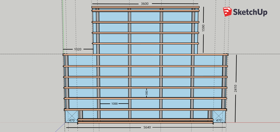

Hi guys! What an awesome forum. I'd like some advice please. I'm planning on building a small deck directly over a concrete patio with only 162mm clearance. I was thinking of using 140 x 19mm Merbau on 90 x 45mm joists and 45 x 90mm bearers dynabolted to the concrete with plastic window spacers underneath to level and clear the concrete sub floor by 8mm, similiar to what can be seen in this terrible YouTube video: https://www.youtube.com/watch?v=QC5d3jDzySQ
My question is, what are the advantages/disadvantages of doing it this way compared to using angle brackets as done here: https://www.workshop.com.au/t5/Outdoor/Merbau-decking-over-concrete-slab/td-p/31230
I've planned the sub floor for my deck, it is completely under cover and the top rectangle is flush into the building with brickwork on all 3 sides, there are also 2 brick piers in the bottom corners. I will be running the decking vertically as the diagram shows and using a picture frame border. I was also thinking of using the Camo Fasteners Hidden Screw system but I've heard that 140mm boards are susceptible to cupping unless the joists are closer to 400mm. I've placed the bearers at 1088mm apart and the joists at 380mm, is this overkill? Is there a better/easy way to do things? Thanks for your time.
