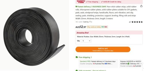

Hi @ironbark,
What about something like this.
With stainless steel screws and cup washers.
That is 3mm try to find a thicken one.
Buy one roll and give it a try.
Mind you I have done chooks for 25-30 years and asking myself...'What about Mr Fox?'.
