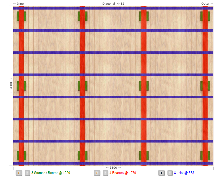

How many bearers are you going to use? With joists of 90 x 45mm, I'd like to see at least 4 as per the diagram below.

I was only planning to have 3 bearers, I have re measured the space and it will only be 3200 wide so the joist spans will only be about 1450. I am basically copying an existing deck section only a step lower then the existing. Hopefully that will be ok.

According to span tables for single-span joists of 90 x 45mm H3 MGP10 with 450mm spacing, 1400mm is the maximum allowable distance between hangers. By using 90 x 45mm for joists at the maximum allowance there is always the potential of ending up with a somewhat spongey deck. Span tables are minimum requirements for building a deck and don't necessarily represent best practise. That's why I suggested the above layout to minimise any chance of significant deflection over the distances.
If you are mirroring an existing deck, which used the same MPG10 softwood timber, then you already know what the new deck will end up like. If you are happy with the existing deck then there is no reason why you wouldn't go with your initial design specs.
