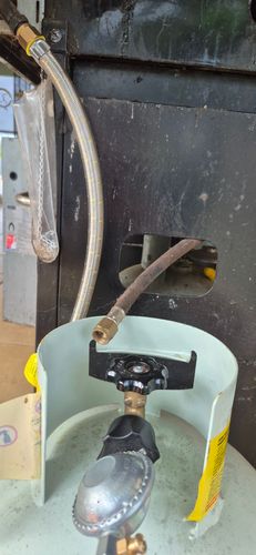

 Hi, I have a Nexgrill 5 burner BBQ it is connected with a gas hose with pol connector and 5/8 unf on the other end. I wanted to replace with lcc27 connector by buying gasmate GM4055 1200mm hose with 5/8 unf connection. Issue is I'm getting no gas flow. Am I missing something or is the lcc27 regulator faulty?
