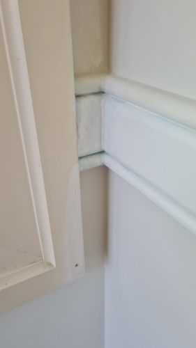

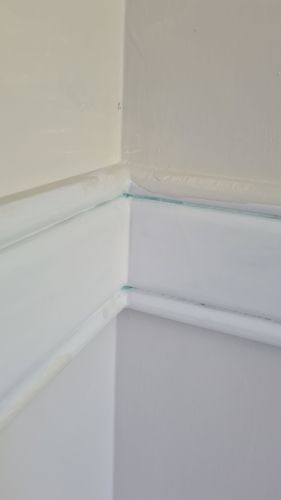

But anyway, in one of the rooms one of the wall trims were gold painted, the trims all got 2 layers of undercoat (sprayed) on them, but now I've got a strange 'blue hue' leaking through the coats...I have attached some photos.
I will be painting the trims a gloss Dulux vivid white... What do you think is going on and how can I combat it ruining my trim paint job?

It is difficult to tell what could be causing the blue tinge on top of your handywork. I suggest sanding the surface back to plain timber and removing any paint that was originally there. It's possible that the sealer is having a chemical reaction with the gold paint that was originally there. If the paint is removed it should hopefully eliminate the blue tinge. I suggest testing a short run and putting primer on top of it again. If it disappears then its the paint reacting with the primer, but if it reappears then it's possible that kerosene was used in one of the original paint products and is reacting with the primer.
