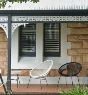

Photo below - this one is under the verandah. I'm planning to use a plain rectangular profile, probably something like 70 x 19 (or whatever standard size is close to that). I like @Jewelleryrescue's suggestion of the hardwood, but I think I will take the easier option this time of using LOSP treated pine. I won't fit 5.4m lengths in the car, does it come in shorter lengths e.g 2.4m?
How do you usually attach them to the window frame? Note that one window is painted shut, the other can be opened.
Hello @IanB
You can ask the team in the timber yard to cut your timber down for ease of transport. As to mounting it to your window, if it is a timber surface, you screw the frame directly to it. But if it is masonry, you'll need to pre-drill and use masonry plugs to screw into.
