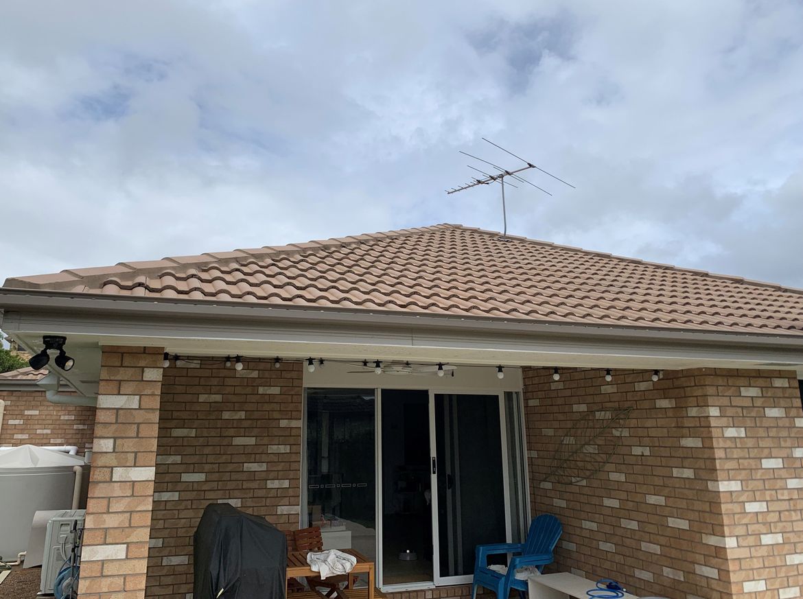

This is what our house looked like before lime washing:

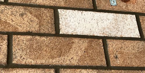

 Close up of the bricks we dealt with:
 We mixed water and hydrated lime to the ratio of 4 cups lime to 2 litres of water in a bucket with a paddle, gives a consistency of milk or very runny paint. This consistency is great to do a first coat or two, but a thicker paste can be made and applied with a rag. We just painted this 'lime milk' with a masonry brush. It's transparent when wet but it dries opaque white. Limewash can be coloured with natural pigments, but we liked white enough.

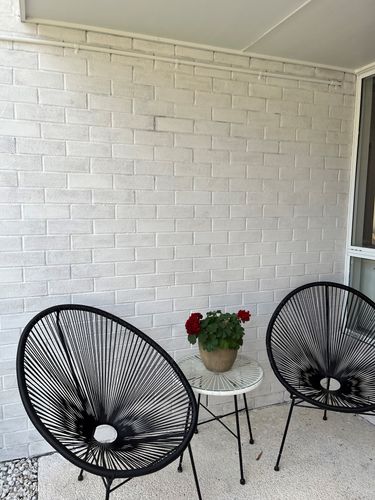

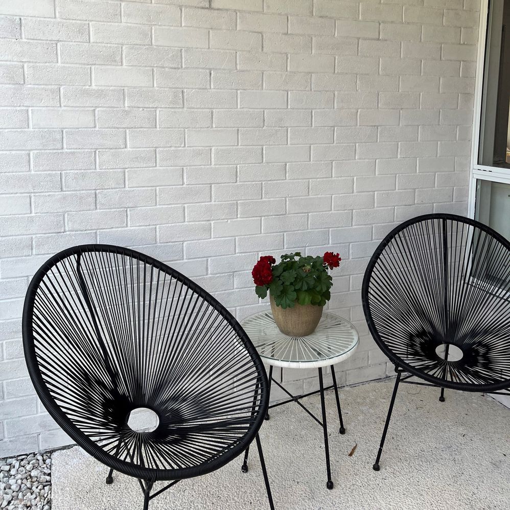

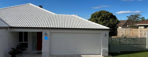

Step 3

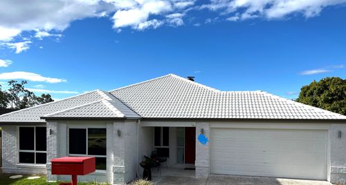

Two coats same consistency. So far we have applied just the two coats.
It returns slightly transparent when it rains or is humid so we may do another thicker coat or render over it when we have funds, but we're overall very happy with the result.

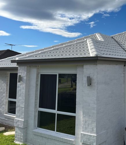

Two coats - photo taken after a recent downpour hitting the front. Showing the look when wet.

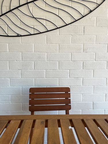

Below photos taken same day where rain didn't hit.
