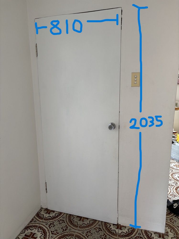

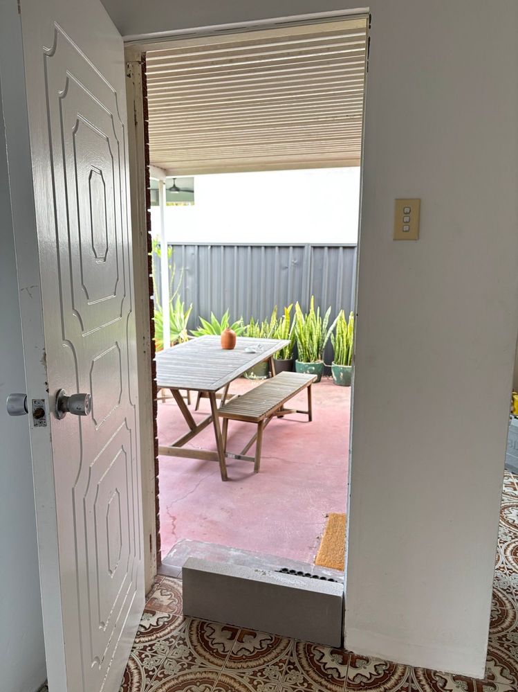

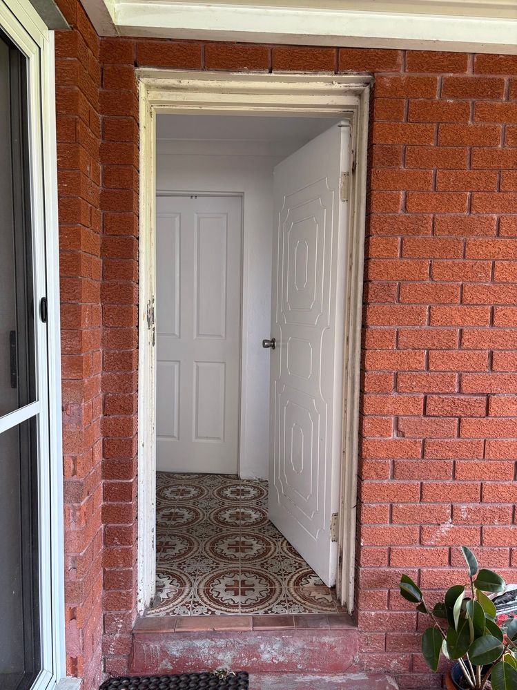

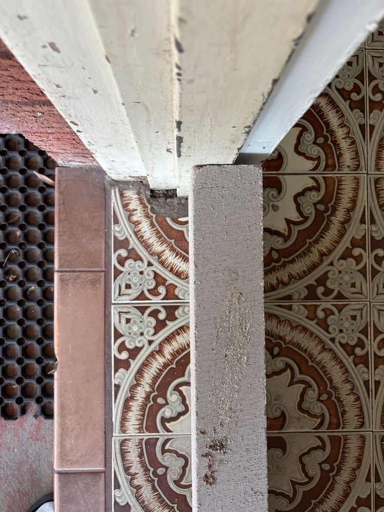

Looking for any advice and guidance on bricking up an external doorway (house is double brick).
Especially the best materials for the internal layer, Power block/Besser block etc and mortar.

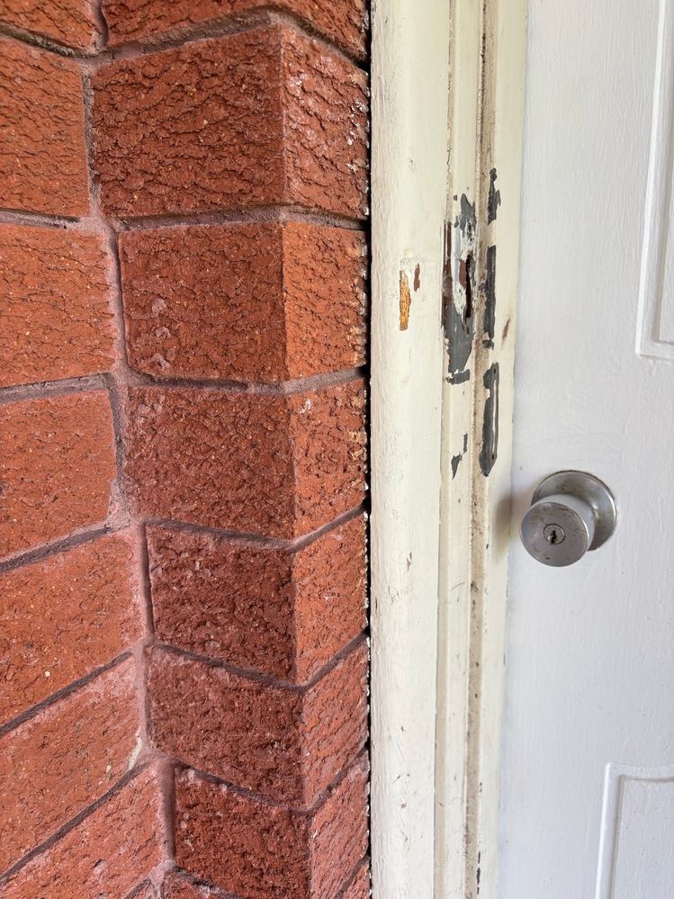

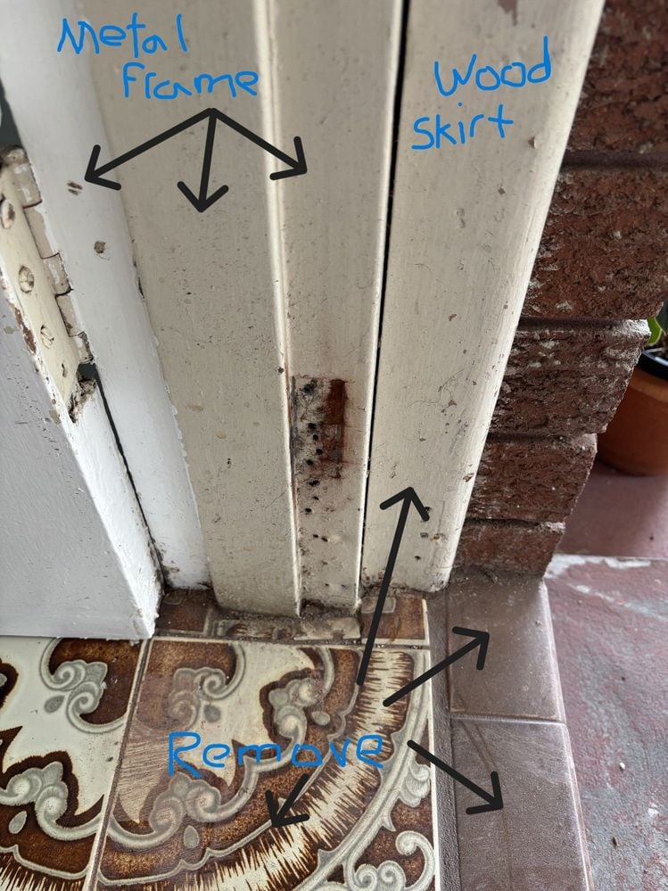

The main challenge is the door frame and jamb, it's metal and can't be removed.
Therefore the internal mortar will be between Besser block and existing painted frame.

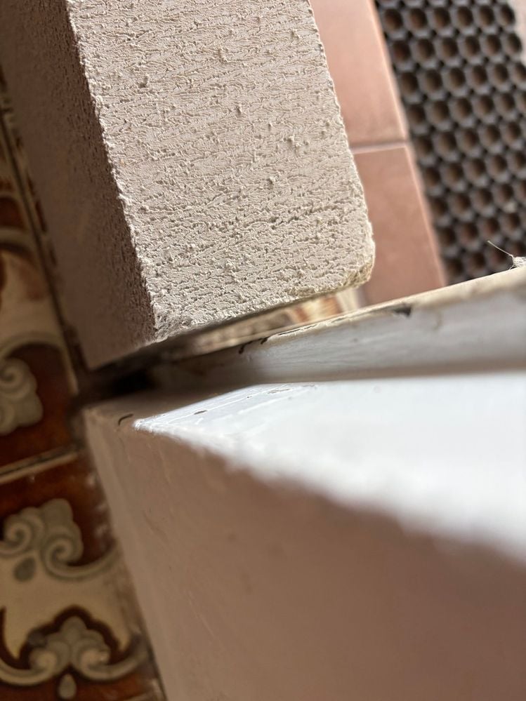

I've got 1 x block to size up (600 X 200 x 075). It's one of these...
https://www.bunnings.com.au/hebel-powerblock-600-x-200-x-075mm-130-plt-csr-powerblock_p0405017
It feels a little too shallow, so might go deeper 100mm depth. However, if using this dimension I can't build a 'running' pattern, so i'm assuming these blocks will need to be cut down. The internal wall will eventually have shelves drilled in, so needs to be pretty sturdy.
Photos and current plan are below.
Many thanks for your expertise!

Remove door, hinges and wooden skirting.
Chip off floor tiles within the doorway, so base row of bricks can be laid level with existing.
External side...
Tooth out half bricks & old mortar either side of opening (Apart from top row due to steel lintel, which will remain).
Build up external bricks (have sourced matching style) with fresh mortar.

Your plan sounds very well thought out. But I would like to suggest building a timber stud frame for the interior which you can anchor onto the steel frame. You can then put insulation in and cover the surface with James Hardie 2.88m² Villaboard Lining - 2400 x 1200 x 6mm. You can then render the surface and match the finish of the interior surface of your home. This will be much easier to anchor shelves onto as you don't need special fixings, you also have the option of adding extra noggings for shelf mounting.
However, it does not mean that you can't use Hebel PowerBlock 600 x 400 x 100mm Jumbo Building Block (which I would recommend). Its larger surface will provide more area for mortar to adhere to and provides better insulation.
Let me call on our experienced members @Dave-1, @AlanM52 and @Nailbag for their recommendations.
