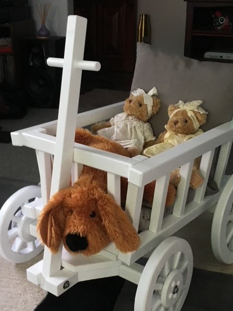

 Hi Petros 2017
Good questions No to both questions No Plans no measurements I checked out the net found a site with some sizes and then scaled up from there
Mine was approx 550mm long and approx 380 wide at the top. The slats were around 200mm long angle around 10 deg. it was all dowled and the only metal parts axles and hinge bolt.
Hope this helps
