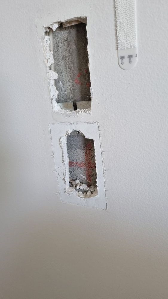

Are you repairing those holes or just showing it as an example?
Hi Dave, thanks for your reply. Hardie™ Groove Lining – "a durable fibre cement VJ sheet panel that gives the look of tongue and groove timber with the durability of fibre cement" (from the Hardie website).
Regarding the photo of the holes, that was just to show the wall makeup - cement blocks + plasterboard with no studs or other framing between the cement blocks and the plasterboard. I don't know how the plasterboard is attached to the cement blocks. but probably glued and nailed I guess. I was just thinking of using liquid nails to avoid filling nail holes.
