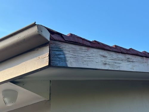

Hi experts,
I'm seeking advice on if I could fix cracked roof pointing mortar myself. I found these crack after gutter replacement. I will for sure talk to the gutter company, while I also want to have an alternative option to fix these myself. I have read other people's post on about bedding and pointing, while I'm wonder if my case is normal or a bit different with others.
I'd like to give it a go myself if it is not too hard.
Cheers,
Han

Yes, it is possible for you to repair your own pointing with Dunlop 10L Tile Pointing Terracotta. If you are only repairing the small side section of your pointing it can be done. But for larger more complex repairs, I suggest engaging the services of a professional roof restoration specialist. They will have the knowledge and safety gear to work properly on top of your roof.
However, before you make any sort of repairs, I suggest calling the gutter company that installed your gutter. If it is currently not affecting the inside of your house, it's best to leave it alone so that they can see what has happened. But to put your mind at ease, the option of self-repair is open to you.

I havnt repaid point as yet, tho I would figure it shouldnt be too hard. Other then the concerns for working at height and having the safty gear. You do want to be able to enjoy your new roof so sometimes it may be wiser letting the professionals do something even if we think its doable ourselves. I for one will only clean my gutters on 2 and a half sides of my house. I can reach the gutters with a ladder, the other sides are two stories and nope, just a nope not wise in my head.
First step Id be contacting the gutter people as @EricL has suggested, second Id be talking to the manager if you arnt happy with the first response. Depending on how long ago the job was done is the level I would be pushing them to solve it more then you considering fixing it yourself.

Personally I would get up on the roof and check the overall condition of the tiles for cracks and if any other peak and end tiles need re-pointing. Then this would justify engaging a professional roof repair person to re-point and replace the broken tiles. It's my experience that a roof in the age category as yours, that it will need some maintenance.

My roof is 50 years old and last major repair (roof painting + some gutter and downpiple works) we done about 10 years ago. I went on it a couple of times, it only has 1 or 2 broken tiles which get glued up with silicone by the roof insulation company. Otherwise the roof doesn't look too bad to me. I haven't notice major crack on it yet.
Do you think it is time for me to get another major repair? Would I better to get a roofing company to check the whole roof? Currently the major ones are 2 damaged pointing in the photo.

Let me tag @Nailbag to make them aware of your questions. If it has been 10 years, I believe it would be worth getting the professionals to come and revamp your roof. Once they have serviced your roof you should have peace of mind for another 10 years.

I also agree with @EricL and would recommend just getting a professional company to get up there and do an inspection report. make sure there are either photos or show you first hand any major concerns. I suspect there will be very little since you did have a full restoration albeit 10yrs ago.

Report back the final result:
Gutter company come back and fixed roof with color matched mortar. All jobs done.
Thanks everyone for your advice.
Now I need to fix the fascia boards.

Thank you very much for the update, it is good to know that the gutter company took responsibility for the tile pointing. In regards to the fascia boards, my best advice is to engage the services of a builder or trades person. They can investigate to see if the fascia board is totally rotted or if it can still be repaired.
