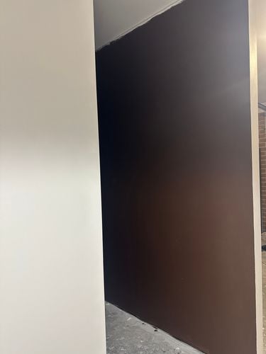

Hi 👋
I love this chocolate colour, however it’s giving 90’s feature wall. I would like to soften the look but keeping it darker.
I’ve seen different options for a faux limewash look using regular paint, and I’ve tried some of them previously (and failed).
Can I dip this colour with a lighter colour to paint over this wall? Do I need to add water (as some suggest)? Is there a method that would work better?
I’m extremely over painting and would prefer to not have to prime again but will if it’s necessary.
Any help is appreciated!

I suggest having a quick look at this guide - How To Get A Limewash Effect With Paint. I think its definitely possible with your existing wall. Seeing that your wall is already painted, I believe you can skip priming the surface. I propose getting a small sample piece of your wall colour about the size of a 10C coin or bigger. Bring this colour to the paint department and ask the paint specialist for colour advice in regards to faux limewash effect.
I would probably hold off with diluting the paint with water unless you are confident with the ratios. The Bunnings guide shows that there is no need to dilute the paint and that technique is important.

I think this might be a challenge to achieve the look you want by painting over in a 'limewash' look. Just adding water to thin an overlay of paint will not work imo and would risk the paint not even adhering properly to the old paint.
You will not need to prime the wall again though. A very light sand all over with 240 grit and a wash with sugar soap and you are good to go with a new paint. Since it is so dark then you are best to go with a dark or mid-tone colour to avoid the need for undercoat if you choose to go light.
Porter Paints have a wonderful range of feature paints that will probably give you a feature look with a softer finish than the good old 90s contrasting brown look. 'The Capusle Collection' brochure has beautiful modern colours that would soften that look. Porters Interior Distemper would give you a look similar to a lime wash (but might not be available at al Bunnings stores). The Dulux Suede effect range is also a nice soft finish.
Good luck but make sure to think abut your colours and how they work with other fixed features of your home like furniture and window frames. Use testers whenever possible.
