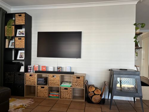

I am wondering if I can install the Prempanel Acoustic paneling behind my new Scabdia Edge 50 wood burner, as long as I leave the required 350mm gap, as per the Scandia instruction manual. I want to have a feature behind this fire place to finish the area off.

I'll need to contact Scandia tomorrow to clarify their instructions. Their requirements from flue to rear wall are clear, but I'd like to clarify the additional caution down the bottom about them recommending combustible materials be kept 1.22 metres away. Perhaps they mean movable combustible materials, unlike their requirements for the walls.
Many thanks for your patience.
Thank you, that would be really helpful. I also read that but at the bottom and thought it very confusing and contradictory to the part above.

Hi @ncarroll83,
Unfortunately, the Prempanel Acoustic panelling can not be used around open fires.
However, I have been informed by Scandia that they are happy for a timber batten feature wall to sit behind their heater as long as there is 350mm clearance and the timber is adequately fixed in place.
