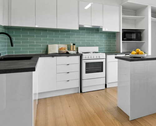

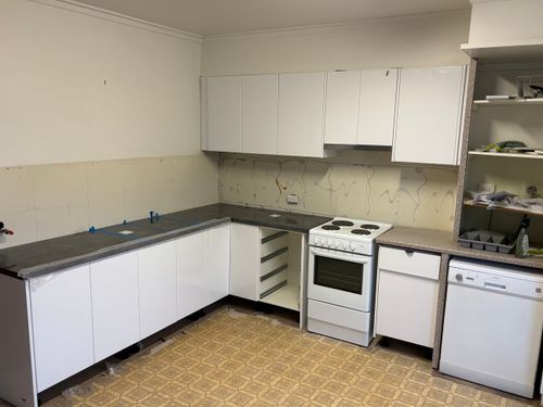

Leave the kick boards off until the floating floor is down. It will be a much neater finish and easier install to fit these on top of the flooring. The standard height to set the cabinet legs is 145mm. So take it up 1-2mm above the height of the floorboards and any underlay. Its the same method I use with any final floor thats going in after the cabinets are installed.

Thanks Nailbag!
Great advice, and the pictures help reinforce my plan.
Great to know that is also the same way someone that knows what he is doing does.
