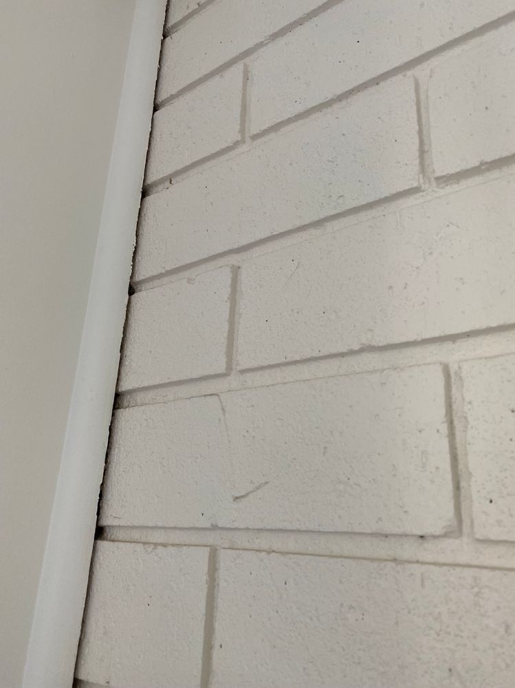

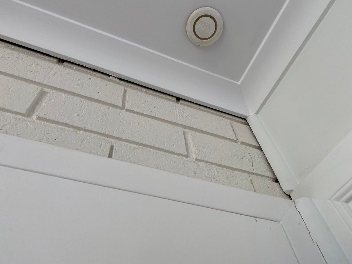

There are also gaps where the brick wall meets adjacent walls, allowing cool air to enter the room (see attached). Would you have any suggestions for filling those gaps?

Good Morning @jtall
Is that the same wall you are thinking about? Quick fix would be to run a bead of silastic around the edges and fill in the mortar parts of the bricks.
selleys 415g brick and concrete sealant but this one is grey in colour, I couldnt see a white one that mention bricks. If you go the route of the VB board/lino/other products you will be removing that edging bead anyway Id suggest. at that point you could fill the gaps with just enough silastic leaving space for what ever type of new edging you put in.
