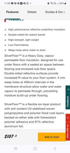

Hi we used the silverfloor underlay under the floors under the house. Might be easier and less dustier?

Hi @projectmumdanni,
Another fantastic option that can help to insulate @Asha8's floor.
This is certainly another product that is worth considering.
