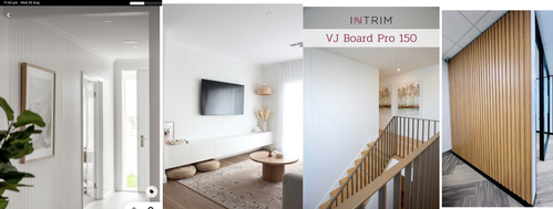

Any suggestions on using Hardie VJ panels in one side wall in Hallways, Living and Stairs wall instead of 13mm Gyprock.
Any downsides to using these? Also, how do you repair them (in case there is damage to it)?
Example :
Hi @Samara1,
What product were you specifically looking to use? Was it the James Hardie 2700 x 1200 x 7.5mm 3.24m² Hardie Groove Lining?
Repairing damage to plasterboard is often easier compared to cement sheets. Plasterboard can be patched, sanded, and repainted relatively easily as a D.I.Y. project. However, repairing damage to cement sheets may require more effort and may not blend in as seamlessly. If damage happens on one of the VJ joints, it would be hard to reform convincingly.
Other considerations would be:
For fitout it would be worth considering whether it would be a more effective approach to install MDF VJ panels over plasterboard instead of using the cement sheet.
