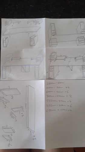

Looking to build a duo computer desk to sit two people and two computers. How do I support the middle of the desk so it doesn't bend under the weight? Also wondering what the best (and cheap) option would be for materials? Melamine or timber?
The desk will be screwed together in the room and the top needs to be able to be unscrewed when we move houses. Everything on top of the desk will be sitting on top, not secured and the two computer boxes will be used as legs for the desk.
I've drawn a few options for supporting the middle of the tabletop, would the triangular shape offer enough support for the weight? I dont want to add a full middle leg because the idea is to be able to slide chairs between the two.

Your triangular support looks quite functional and should be sufficient to support the central area. It would need to extend out at least halfway across the depth of the desk. Alternatively, you could use a stayed bracket.

Thanks heaps for your help! You've answered a lot of my questions, with the middle support, it will need to go to the ground as we're currently renting we can't screw into walls or lean against them.
