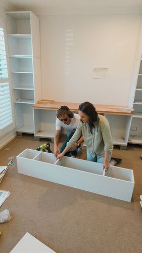

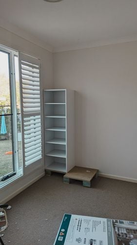

We started by building the two side 6 shelf units.

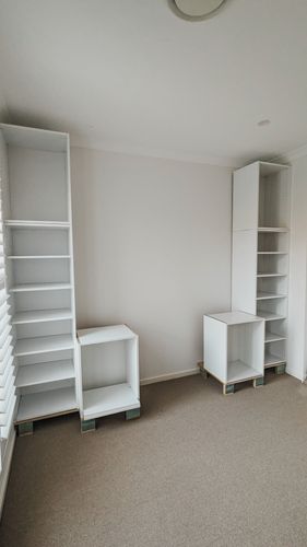

We created a plinth by cutting the yellow tongue to size and making some legs from the structural pine. These were attached by nailing and screwing down through the yellow tongue.
Step 3
We then cut the sides of the two 4 drawer units in half and assembled them into four units: 2 sets of drawers and 2 shelf units which we screwed onto the top of the 6 shelf units.

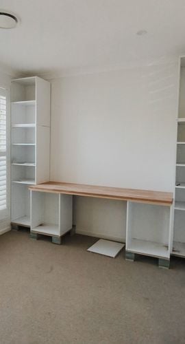

After this we screwed everything into wall studs to secure. We then cut down the Beech Panel for the desktop and attached it to the structure.

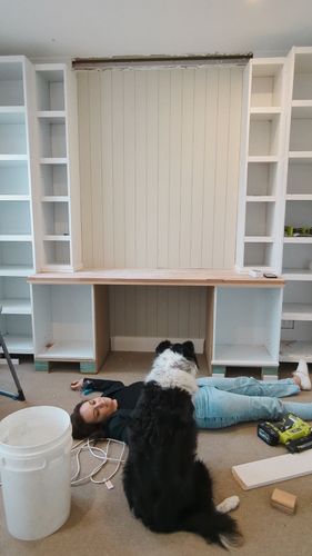

Next we took the last 6 shelf unit and cut it vertically on the table saw to create two slimmer units. We used some melamine to create the missing side on each and nailed and glued together.
Step 5
We then added Easy Craft VJ panelling to the wall, screwing and nailing into studs.

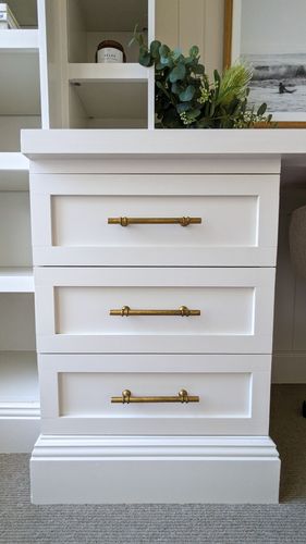

Step 6
Next we added trim around the base, base of the slim units and fronts of all the shelves and verticals. We also added cornice to the top and a shaker style profile to the drawer.

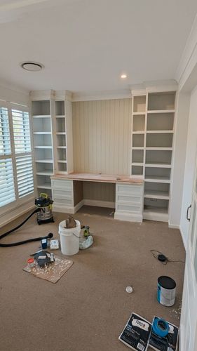

Step 7
We filled with wood filler and allowed to dry for 24 hours before sanding with a foam sanding block
Step 8
Next we taped and sheeted off the room so we could spray the unit with BIN Zinsser Shellac Primer. We used two coats, sanding lightly between.
Step 9
Then we sprayed Dulux Aquanamel in White Beach Half. It took two coats, plus a few touch ups, sanding between each.

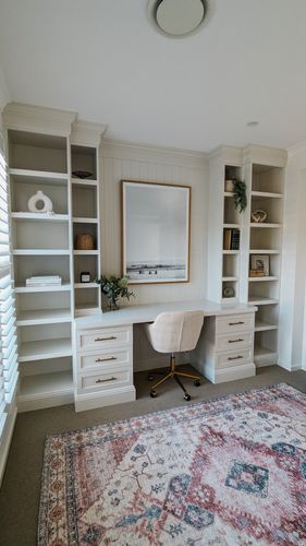

Step 10

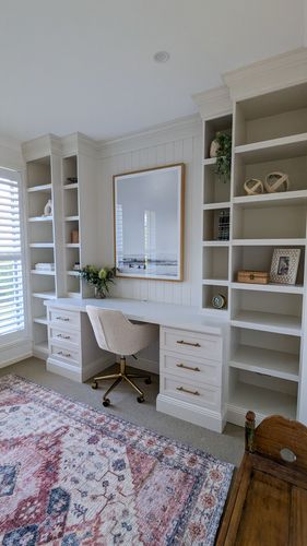

Here's the final result!
