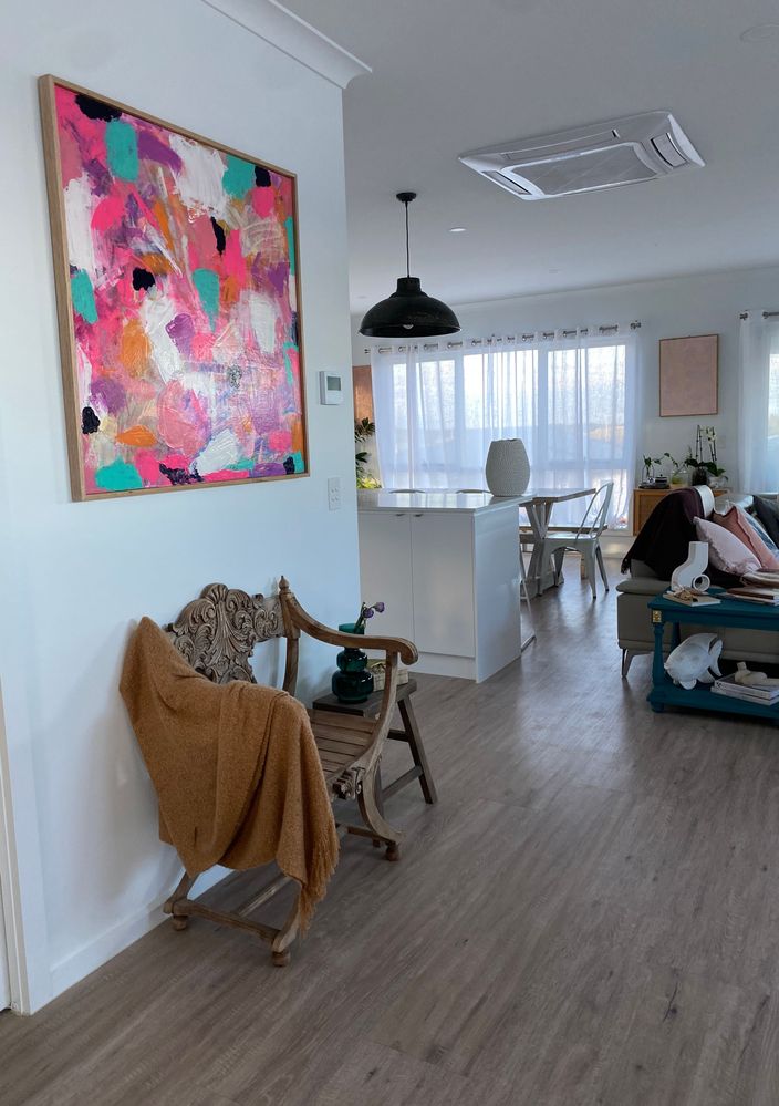

This DIY Canvas Artwork and Frame was completed to add colour and artwork at an affordable price for our family
Materials
1m x 1m Canvas
Tasmanian Oak Framing Timber
Acrylic Paints
Tools
Ryobi Brad Nailer
Ryobi Drill
Steps
Step 1
Painted the Canvas over the period of 10 days to ensure each layer was dry before I added to it
Step 2
For the Timber Frame, I cut the first piece to a 45 degree angle then lined it with the canvas to measure the next cut, I continued this process for all four sides.  I always measured twice and cut a mil or two longer just in case, this worked everytime
Step 3
I added clue to the corner cuts and held them together and then added two or three nails to each corner to ensure the frame was secure and stayed together
Step 4
To secure the canvas to the frame I pre drilled holes the whole way around the back of the frame, pre drilled a wider hole 2 mil dee as I was using countersunk screws to keep the canvas and frame together
Step 5
I then added to hooks out of the Picture Hanging Kit and added the wire and then hung to the wall

I knew it needed the floating frame to make it pop and well I think it has done just that.  Cutting the frame by hand was both challenging and rewarding and I love how it’s all turned out.
