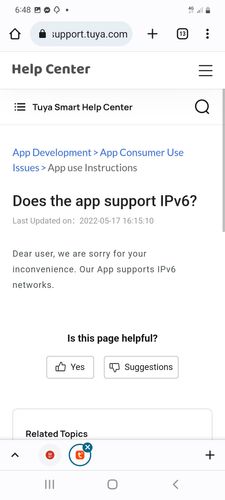

The other option If no joy download Tuya Smart or Smart Life app both are Tuya products which is the parent of Grid Connect App, and I believe they accept the IPv6 protocol, you will need to reflash your devices into the app.
Worth a try anyways.

@Glockers you don't need to reset it just exit out of Grid Connect then open up Tuya and then click on  the plus symbol to add a product and follow the instructions, all the information will come across into Tuya.
