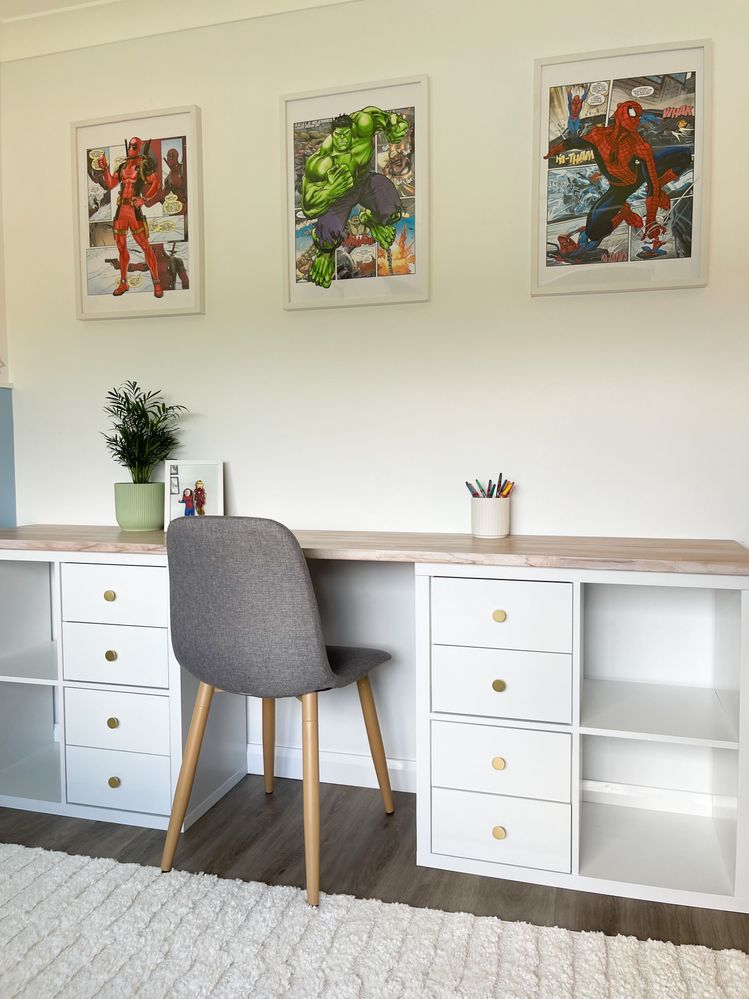

Assemble Cubes as per instructions
Assemble and Install Drawer Inserts as per Instructions
Measure and mark your timber panel in preperation for cutting. I went with the 2200 length but decided to cut it down to match the depth of the cubes.
Cut timber using track saw
Sand and paint timber panelling. I decided to white was mine and seal but you could use any colour paint or timber stain.
Once timber panelling is dry, attach the timber panel to the top of the cubes. If you plan to relocate your desk and need to unassembled I recommend screwing it onto the the cubes. I used Liquid nails as we don't plan on moving it for a long time ![]()
I chose to attach a different style of handles to the drawers that suited the room more ![]()

thank you @MitchellMc , very happy with the finish product ![]()
