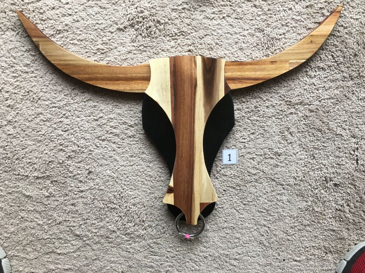

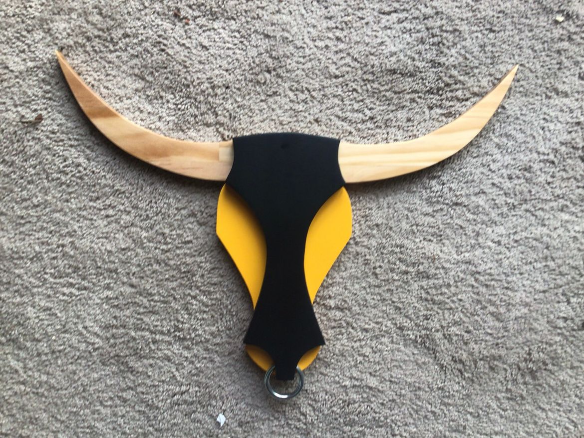

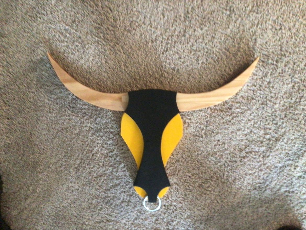

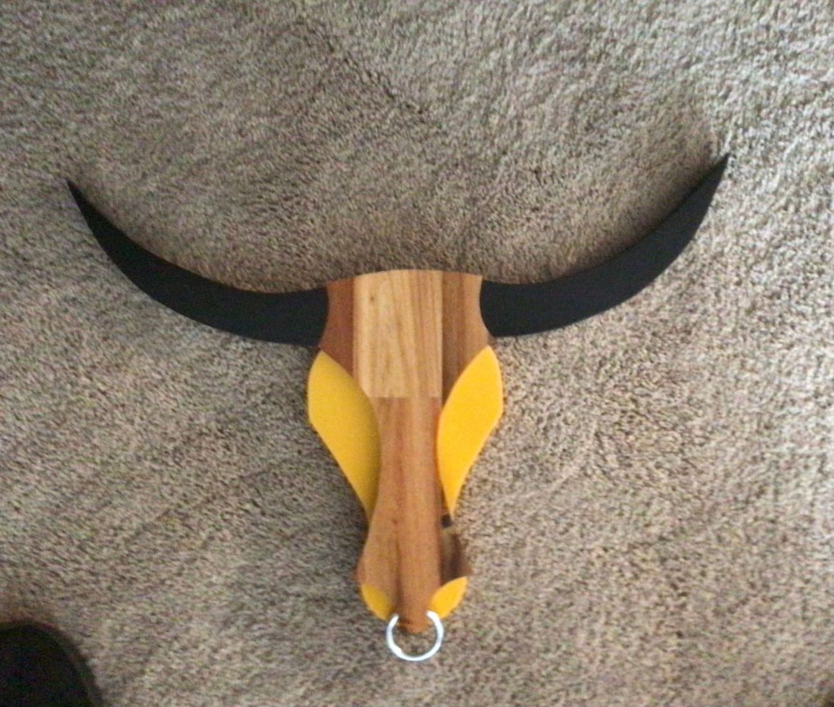

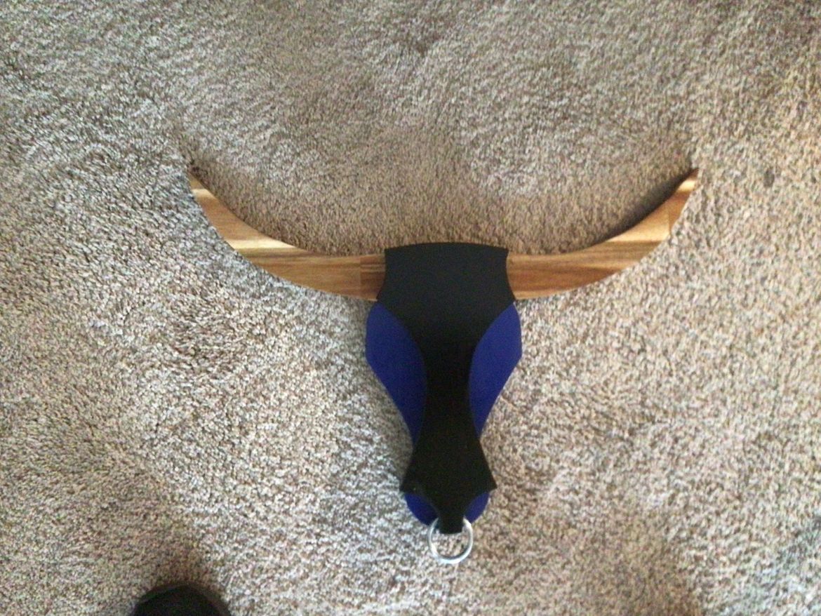

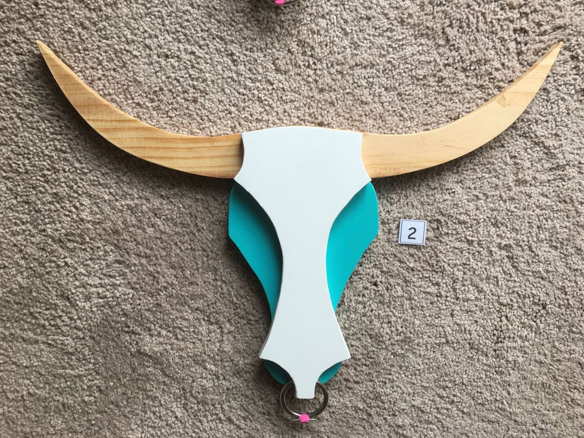

Let me know if you’d like the pattern I found on the internet
the horn tips are 500mm approx wide, three easy to cut parts and a metal ring.
I used a Ryobi jigsaw to cut the shapes out and Ryobi multi tool to cut out the notch for the ring (36-40mm).
the timber was sanded pine or sanded finger jointed acacia. I’ve used Rustoleum spray cans to paint the parts and satin clear for wood finished components. I like the satin finishes but gloss is fine. Matt is only suitable for interior ONLY
9DBF674F-BA30-4116-B892-4A238DA0120A.jpeg6362BDF0-F515-44D0-9BC1-C24F43251E3F.jpeg1B9BE5DF-2A8C-483B-913A-C7D4081D3900.jpegFEFA8B1C-1E65-4704-B881-741EC5DB5A99.jpeg9415B897-1586-4AD3-B047-CB81D5173234.jpegEFD43634-913C-4A95-9BA5-2A45598E660E.jpeg861376A7-BBE8-4652-A7B1-74B95D12CFC9.jpeg0DF24757-81E0-4BE6-A06F-4D562FBF789B.jpegboards from Bunnings.
