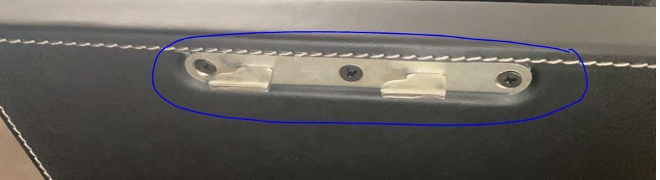

I started assembling a desk and i need to have a matel sheet with two hooks ( see attached)
Can someone please let me know if i can get it from Bunnings?

That appears to be some type of proprietary fixing used by the manufacturer to join the desk together. I am not aware of any generic fixture that would replace it. Have you contacted the manufacturer to see if a spare part was available?
Your fixing seems to work on a similar principle as the Hafele Bed BracketSet and Kia Ora 120 x 40mm Gold Maxilock Bed Bracket, so you could perhaps use one of these instead. Alternatively, depending on how the bracket attaches to the other piece, you could use a standard L bracket. You might like to show our helpful members an image of how the joint goes together as that would allow them to suggest alternative products you could use. Let me mention @redracer01 in case he has seen this bracket before.
I look forward to hearing further details on the fixing mechanism and offering a solution to your issue. Please let me know if you have any questions.

Please see attached pic of the other side where it needs to go into..
Also, please be advised that yes i asked the supplier but they mentioned that they don't hold the spare parts for the desks.
Thank you so much for your assistance ![]()
I'd suggest the best method of fixing the panel would be with an L bracket @sdahiya. One could be screwed directly into the desk's frame and then into the back of the panel. It appears to be a steel frame on the desk, so it would be best to use Zenith 10G x 30mm Galvanised Wafer Head Metal Screws. These screws are self-drilling, so you won't need to drill any pilot holes.
