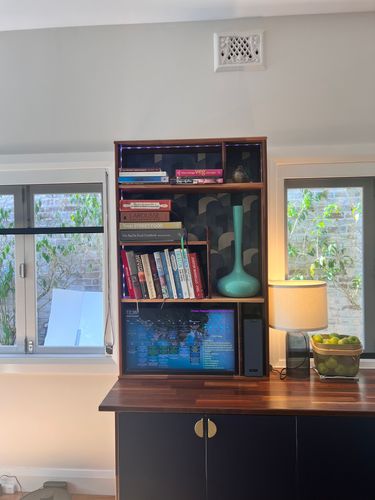

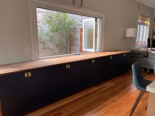

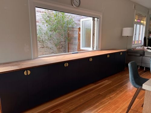

have a very long slim open plan room that is our lounge, dining and kitchen area. I needed more storage and had this space around this 2.5 m window. The only problem was that most store bought options were too tall as the windows are quite low. So I came up with this design.

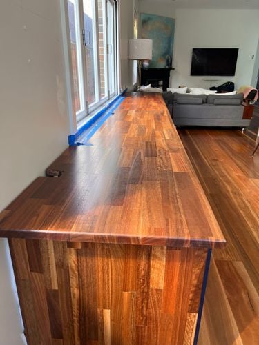

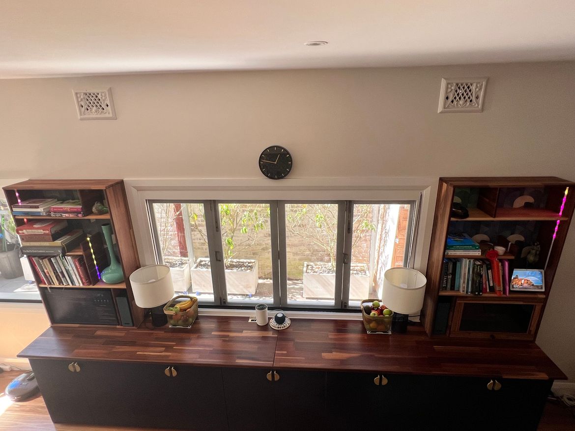

It measures 4 meters in length with 5x800mm cabinets at the base. It’s wrapped in Specrite Spotted gum panels. I made a 50mm plinth to go underneath so the top of the bench top finished just under the window.
the centre cabinet has 4 drawers in it which I made out of plywood and melamine panels, joined with pocket hole screws. The top draw is charging station for family devices and the rest hold napkins etc.

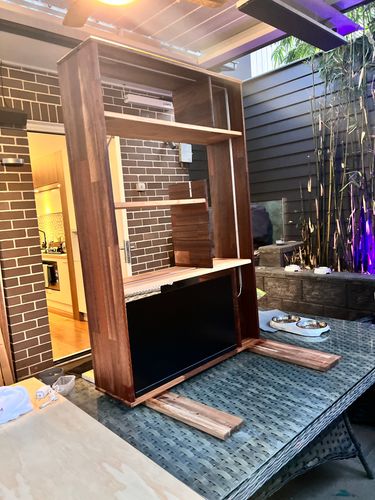

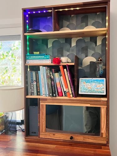

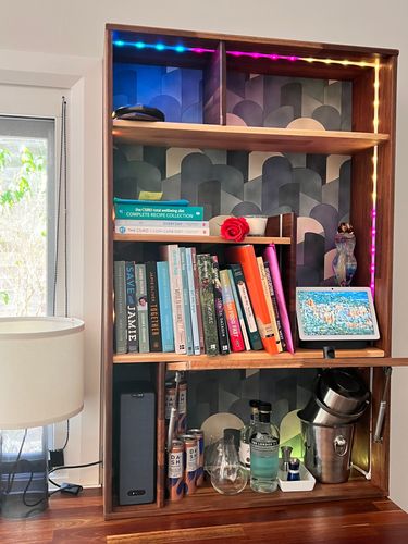

i used spec-rite spotted gum and beach panels to create the two book cases. I like mid century design and had some pieces I wanted to fit into each book case hence the layout of the shelving.

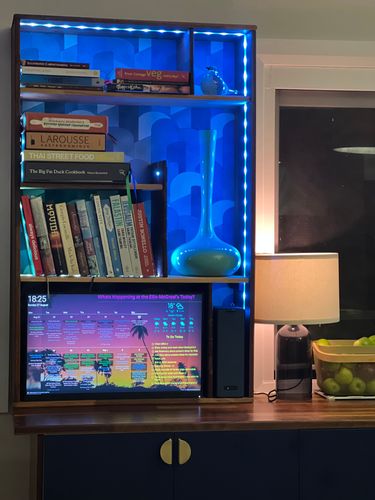

i fitted our home made Family Dashboard on the left hand side and to balance the piece I made a bar in the right and created a shaker style door with black mirror Perspex so it matched the screen on the right.
i routed a groove all round the inside of each bookcases and put LED strips to add some lighting and fun .

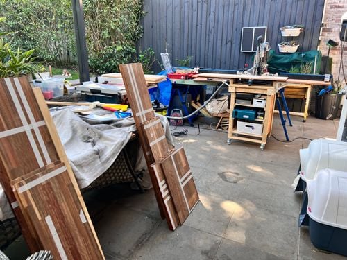

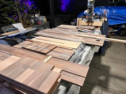

2 x 2.2x600 spec-rite spotted gum panels
6 x 1800x300 spec-rite spotted gum panels
2 x 1200x 300 spec-rite Beech panels
2 1200x600 spec-rite spotted gum panels
5 800x 600 x 720 Trademaster double door kitchen cabinets with French Navy doors

Table saw
Mitre Saw
Router
chisels
plane
drill
driver
pocket hole jig
sander
mesh sanding pads - sanded to 240 grit
Hi @RainbowDiY,
What a fantastic custom cabinet!
The amount of thought, detail and effort that were clearly put into this project is truly remarkable.
I love the contrast between the cabinet faces and the gold hardware, they work so well together.
Congratulations on a wonderful project that maximises the utility of an otherwise unusable space.
Afternoon @RainbowDiY
Thats a nice use of space and very stylish. The timber top gives it a solidness and plants it in place.
Love the planning that you put into it
right down to the speaker slot and weather screen ![]()
Definently adds to the rooms feel.
Thank you Dave.
i think i went through about 100 iterations of the design before coming to the right one !
It is such a useful piece !
