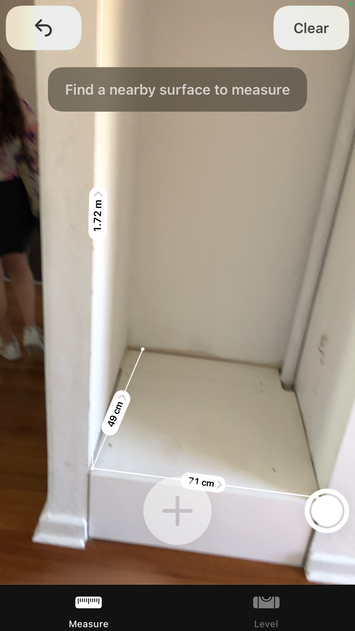

It is being used as a platform to support the front two legs of a fridge. Our situation is that we have a place for a fridge to go in our apartment that is elevated, but it isn't deep enough for our fridge, so the front feet of the fridge hang over the edge slightly. An image of the space is below (ignore measurements as they are inaccurate).
Would the two pieces of the suggested timber be strong enough to support this? It seems like with this timber, the timber pieces would be sitting on their side.

Thanks for sharing the picture of the space for your fridge. It seems from the picture that the height of the raised area is taller than the 60mm you specified. However, In regards to my recommendation of using 2250 x 600mm 30mm Plywood Pine BC Grade, it should meet up with your fridge feet. I've placed a diagram below, can you please tell me if the orientation is correct? The panel I've recommended is the closest one to the sizes you require.

The height from the floor is 303mm, and then needs to come out from the wall by 60mm.
Thanks for the drawing! The orientation of your drawing would need to be standing on its side longways.
