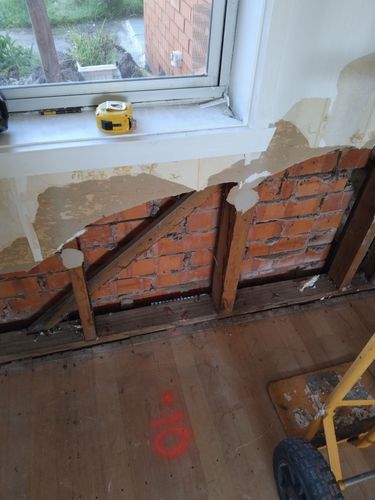

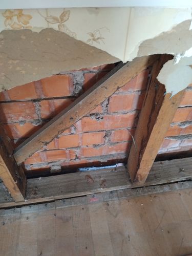

I'm insulating all the walls. It's single brick . I will use rockwool r2.5 acoustic batts
Do I need a vapor barrier filt behind the batts for extra protection? I do live in melbourne

It's important to have sarking as it prevents your insulation batts from coming in contact with the bricks and mortar and wicking moisture from them to the timber frame. You can retrofit Ametalin 1370mm x 30m VapourTech Brane VHP Vapour Permeable Wall Insulation between studs. Measure the width between your studs and add 100mm to that. Cut the sarking into strips and use a staple gun to staple 50mm to the side of one stud at the back. Place a staple every 200mm. Transfer across to the next stud and staple it to the side of that one. Repeat this across the span. You'll then be able to install your wall insulation.

I did found some information and it says I have to place it next to the internal wall lining? That means I have to also put it in between the gyprock and insulation batts? Ametalin recommended that in colder climates like Melbourne
Maybe I'm reading it wrong.
I spoke with Ametalin technical support, and I have advised what they suggested, @michaeljb. There was no mention of needing to line between the batt and wall lining. If you can link me to the information you've come across from them, I'd be happy to follow up for qualification.
