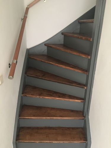

IMG_3296.JPGHere you go. We went for a bit of an industrial look and feel....It's nothing fancy but better than the yellow carpet and ugly (stuc) walls we had before.

Wow well there you go, I love seeing a final product that was the result of a different technique rather than just using any normal stain.
Great work and now you can own these stairs and call them your own 👌🏽
