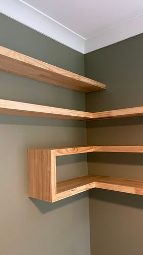

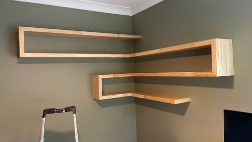

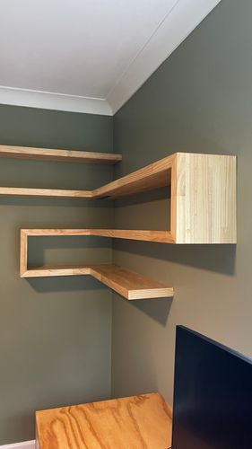

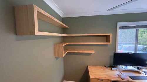

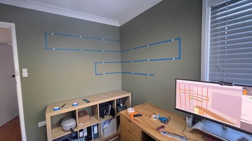

Measure everything and mark with tape and double check. Pre drill holes through the chip rock into the studs. Screw in floating shelf mounts and at the end, slide the shelfs in.

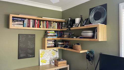

Step 5
Finishing up and triing to fins s[pace for everything. I really enjoyed the process, and it turned out great.
