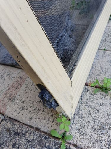

    I have a fairly old sliding flyscreen door that has a broken roller assy that needs replacing. If it was just the wheel/roller that needed replacing it would be a fairly simple task, however the plastic housing that holds the roller is broken.
I need some advice on how to remove the whole roller assy as there seems to be no obvious way of getting it out or are these sealed units where you have to renew the entire screen door ?

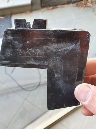

 Hi, as a follow up to this post it ended up being a sealed internal  corner piece, have not  one across these before.

Many thanks for the update, @DionSouthwell. Is it all one sealed unit that you need to disassemble the corner to remove? I wasn't actually expecting that, but now I'll know for next time!
